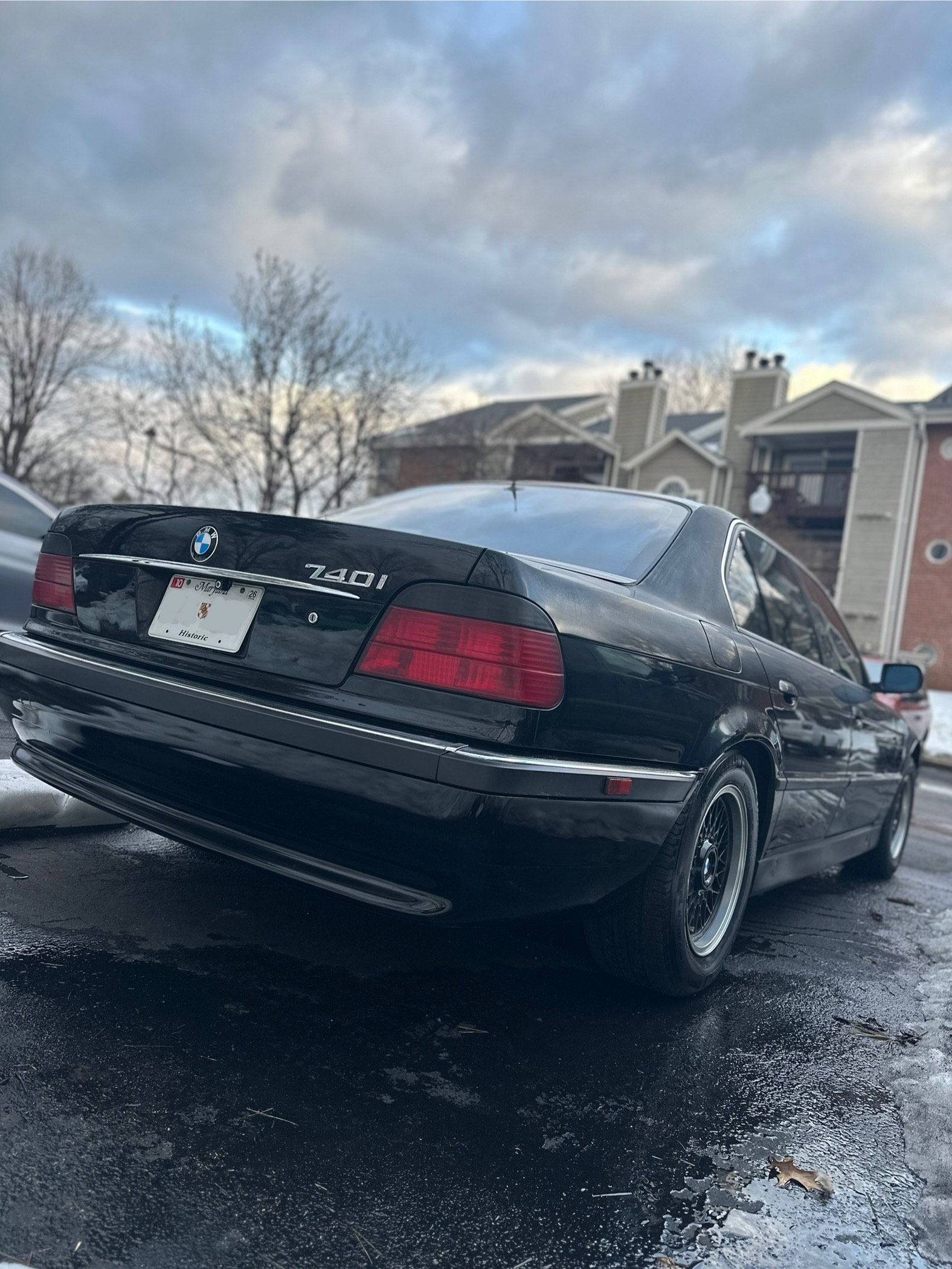

Acquired My Very First BMW - 1998 E38 740i
Last week I purchased my first BMW a decently maintained 1998 E38 740i in Schwarz Black over Tan Interior.
Only has just over 160k miles on it.

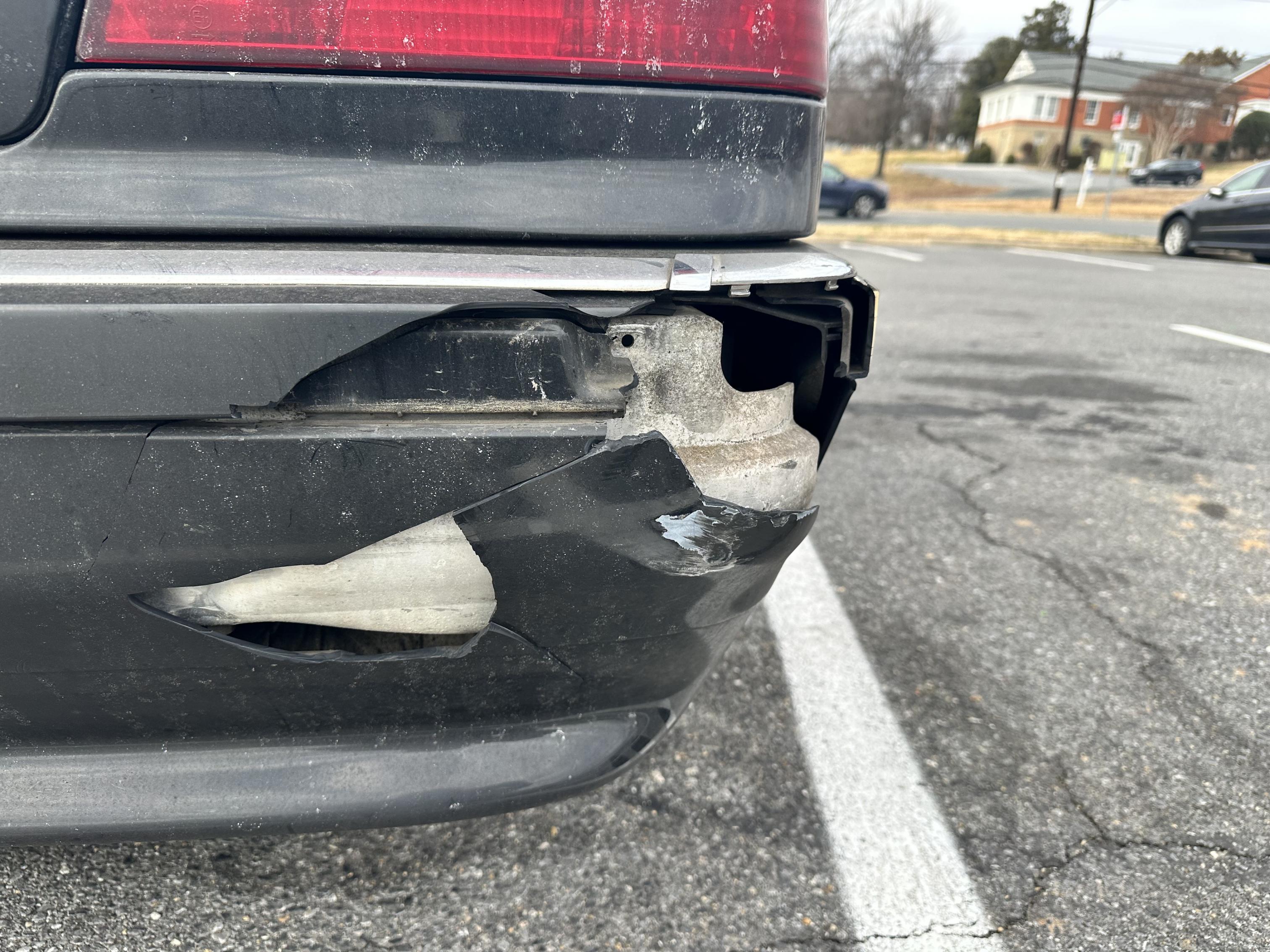

Lastly, I had an incident occur where someone hit the car in the back passenger side corner of the rear bumper and fled the scene while it was parked, and unattended in a parking garage. I was able to get footage from parking garage camera and information from a witness and file an insurance claim with the hit & runner's insurance.
I was nervous that given the age and mileage of the car that it might be totaled out but to my surprise after the body shop gave a nearly $2000 estimate to fix, insurance went ahead with paying for the repairs to the car.
